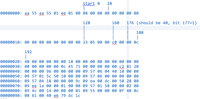

I am trying to turn on a custom board using the LS1012A.  I had hoped to use the CodeWarrior QCVS component to first load a known valid RCW from the FRDM-LS1012A development board (in the QorIQ SDK) and then tweak the settings to account for the differences between the FRDM-LS1012A and my board.
Unfortunately, I encounter an error when I import the "known good" RCW binary for the FRDM-LS1012A into the PBL component.  On import, it generates the warning:
Warning: PBL: Not supported value of `SRDS_DIV_PEX[176-177]` detected during import, custom value '0b00' can be used only if "Ignore Constraints and non-Critical Errors" option is turned ON.
Sure enough, the xxd Object Dump shows that bits 176-177 are set to 0b00 rather than 0b01:
So I'm puzzled as to why the RCW for the FRDM-LS1012A which yocto built (QorIQ-SDK-V2.0-20160527-yocto/build_ls1012afrdm/tmp/deploy/images/ls1012afrdm/rcw/ls1012afrdm/N_SSNP_3305/PBL_0x33_0x05_800_250_1000_default.bin) and which appears to come from SRC_URI = "git://git.freescale.com/ppc/sdk/ls2-rcw.git;branch=sdk-v2.0.x" (ls2-rcw.git/ls1012afrdm/N_SSNP_3305/PBL_0x33_0x05_800_250_1000_default.bin) has this illegal value for bit 177?
I'm also puzzled about what a person is supposed to do in this instance?  If I disable the constraints and error checking, then I the tool won't help me avoid errors in my own work.  Plus, I'm guessing it will leave bit 177 set to 0 in my results too--which doesn't seem like a good thing since the documentation says it should be set to 1.
Since the PBL configuration editor doesn't present the hidden/reserved field values, there doesn't appear to be an easy way to edit the value to fix the bit using the tool--and hand-editing the object dump corrupts the checksum.

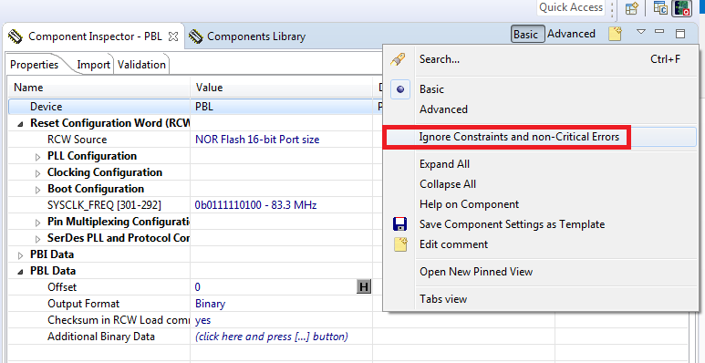

addiyi
Ignore Constraints and non-Critical Errors option should be used in this case. For doing that take a look in below image:
Using this option you can select what bit field you need.
Adrian

brettstahlman
How do I access this option on Linux? I don't see any such menu under the Basic tab and I am using QCVS version 4.10.
UPDATE: Found it. I wasn't accustomed to the Eclipse menu buttons (inverted triangle)...
