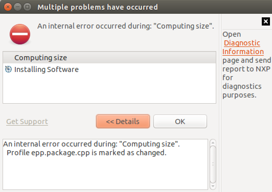

ACGarland
Yiping Wang wrote:
After install CodeWarrior 2017.03, please install the patch(zip) file in CodeWarrior IDE from Help->Install New Software->Add->Archive, please specify the path of the zip file and follow the installation wizards to install it step by step.
I was able to add the ZIP file as an archive, but during the install process encounter an error:
I'm assuming this means the patch doesn't successfully get applied?  Any idea what this problem may be?
I've attached the diagnostic info that was created (as mentioned in the above dialog).
