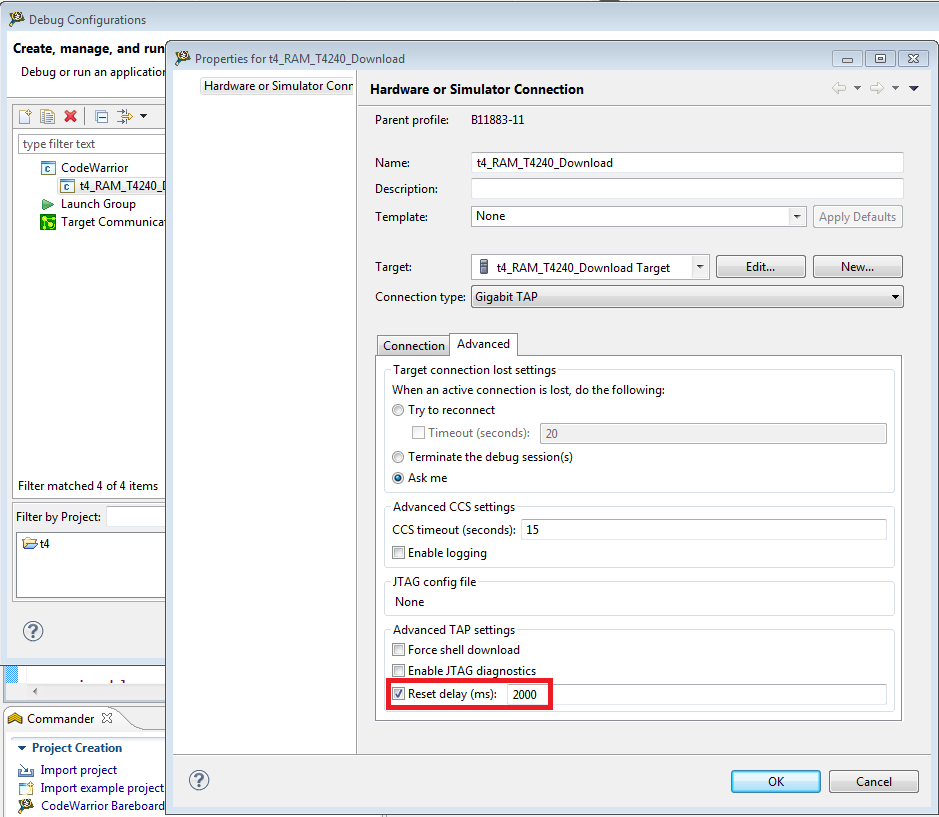

   We are trying to run the bare board example program of CodeWarrior on the T4240QDS.
   HRESET is alaways on. Any clues on how to resolve this issue?
   Any help will be appreciated.

Could you try from CW, to add 2 sec Reset delay when connect to the board? Using some fpga version this is required by CW to connect to the board.
But, please make sure a valid fpga is programmed to the board.

For FPGA version 5 (T4240QDS_2013_0509_1415_V5), CW should works with no issues. I attached the image I used.
For FPGA version 6 (T4240QDS_2014_0522_1552_V6), CW will need a 2sec Reset delay (Go to Debug Configuration -> Edit -> Advanced -> Reset delay).

chrisyao
Dear Adrian,
  We set the reset delay as 2000ms, but still can't connect target board, and the HRESET led still on.
The fpga is valid , when we found the diff stp files(mentioned above) worked not the same.
