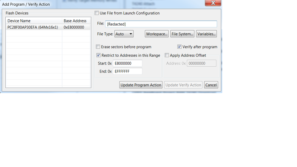

I am using a slightly different flash device (PC28F00AP30EFA) but I'm assuming an algorithm that works for the original post's device would work for this as well.
I created a new device xml per the "Creating an External Flash Algorithm" (AN3389) document (see PC28F00AP30EFA ).
Below, you'll also find the log (See "Flash Log" section). As you can see, it says everything succeeded but 0 bytes were programmed and to check the restricted address range. I checked what I had selected as the restricted address range and it looks fine. (Note. I also have "Erase" and "Unprotect" actions listed before the "Program and Verify" Action).

yipingwang
Hello Jesse McCall,
Please check "Apply Address Offset", and specify the address of u-boot, for example, if you want to put the image at the beginning, please specify the address as "E8000000".
In addition, please specify the file path of the image which you want to program to NOR flash in the above panel.

jimccall
Hi Yiping Wang,
We're actually trying to get the PBL/RCW into NOR flash.
I checked the "Apply Address Offset" and specified the address as "e8000000"
I specified the path of the image I wanted to program in the panel, I just redacted it for purposes of the post.
Now, after doing that, it gives me the error of  "Sector Protection Error" even though the "unprotect" command seemingly succeeds.
If I issue the actions: "Unprotect", "Erase", "Program" it gives the following:

7,136 Views
yipingwang
Hello Jesse McCall,
This CW initialization file is not for MPC837x at all, it seems it is used for T series.
IFC controller setting is used in the init file, but MPC837x integrates eLBC.
CPC as SRAM is used in the init file, MPC83xx processors don't have CPC at all.
Please port CW initialization file according to the one for MPC837x demo board.
If you feel difficult for CodeWarrior initialization file porting, you could create a new thread to discuss more.
Yiping
7,136 Views
jimccall
Hi Yiping,
I'm actually using a T-Series processor. I stumbled upon this thread looking for solutions for the flash algorithm related to the flash device as opposed to looking for the flash algorithm related to the processor.
I was under the assumption that the flashing algorithm would be processor-independent. Sorry for the confusion!
7,136 Views
yipingwang
Hello Jesse McCall,
Would please create a new thread to describe your custom board more clearly?
Yiping
