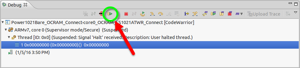

4. Start the debug process by clicking the debug button in the debug configuration window accessible under RUN menu.
5. After the Debug process started with successful connection to the board, click the resume button so the code is executed:
Steps 6 to 9 can be completed in advance or once, before debug session is started. For reuse of the method, these steps can be skipped if target task is already setup.
