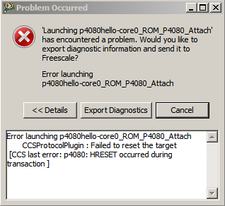

I have a custom p4080 board. I am facing this error: ccs protocol plugin : failed to reset the target.
I created a bareboard project and didn't change the default source files and built it.

When I try to download this code to the p4080 device I get the error above

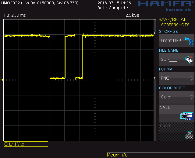

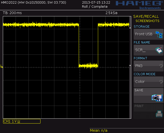

I checked the jtag connections, they are fine. I scoped the reset signals of the Jtag interface during running the project, the CW USB TAP resets the device with TRST and HRST signals. SRST signal stays at logic 1(deasserted), Here is the HRST(first one) abd TRST(second one) scope screenshots:

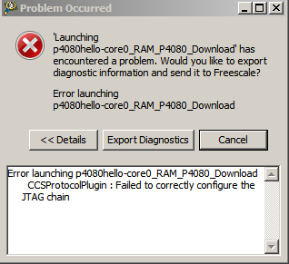

When I give power to the board the ASLEEP signal of P4080 keeps at logic "1". When I hit the RUN I get a different error: Failed to correctly configure the JTAG chain.

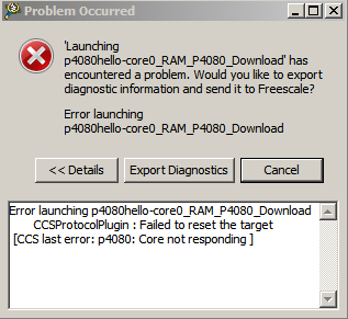

If I push and release the PORESET button on the board(pulls down the PORESET signal) the ASLEEP signal turns to logic "0" and when I hit the RUN after ASLEEP signal turned to logic "0" I get this error constantly: Failed to reset the target
Here is the error windows:

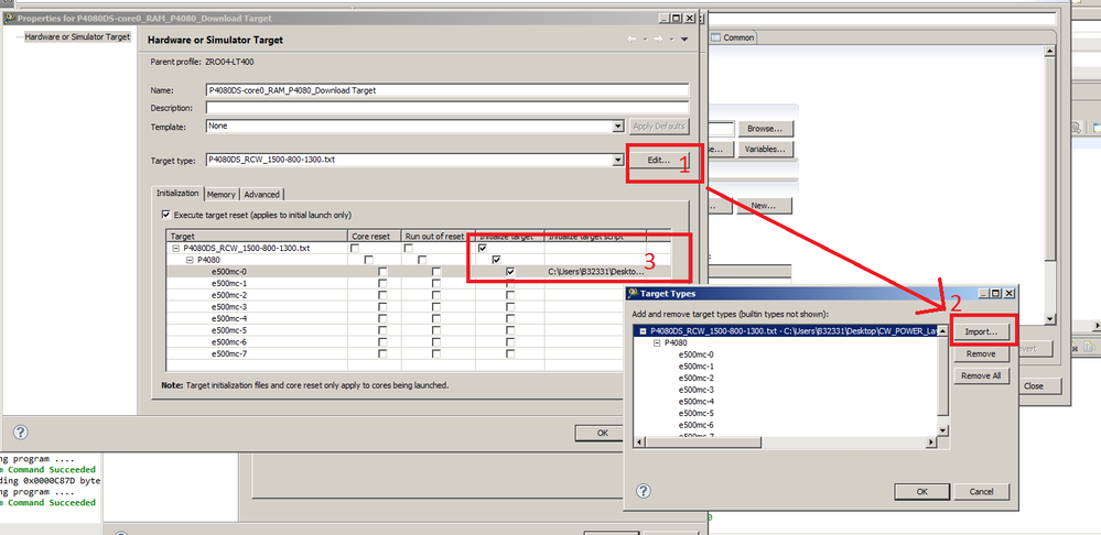

marius_grigoras
Hi Emil,
Please make a try using the Connect target and use the sram initialization file (PA\PA_Support\Initialization_Files\QorIQ_P4\P4080DS_init_sram.tcl) instead of core tcl file. Also use the jtag file (this will enable a RCW override mechanism - very useful if your board doesn't contain a proper RCW according with board settings). The jtag file can be find here PA\PA_Support\Initialization_Files\jtag_chains\P4080DS_RCW_1500-800-1300.txt.
You can make the both settings from Debug Configurations - please take a look to attached picture (steps 1 & 2 - used for   setup the jtag file and the 3rd step for replace the core tcl file with the sram tcl file).
Regards and please let me know the results,
