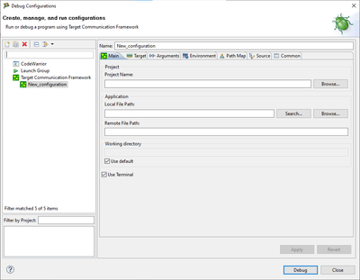

I am using a CodeWarrior TAP to CodeWarrior on a T2080. I need it just to flash the board but I can not get find how to connect the TAP to  Version: 10.5.1.
I went to the Run menu and Debug config and can not find the connections tab.
Any help would be great. Thanks.

For flash programming with CodeWarrior for PA, please refer to the attached application note AN4948.
Here are some simple steps for you.
1. Please create a new bareboard project for QorIQ target following new project wizards from File->New->CodeWarrior Bareboard Project Wizard. In Debug Target Settings panel, please specify Connection Type according to your requirement.
2. Connect CodeWarrior to the target from Run->Debug Configurations->CodeWarrior-><project>-core0_RAM_<processor>_Download->Debug.
3. Open Target Tasks panel from window->show view->Target Tasks, right click root and import a xml template file for your target, modify the flash device and add Erase and Program tasks.
4. Execute flash programmer tasks.
