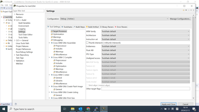

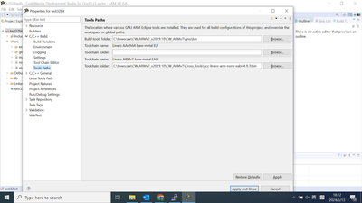

You could use 32bit toolchain provided in CodeWarrior for ARMv7 to build your program.
You could download and install CodeWarrior for ARMv7 from the following link.
https://support.nxp.com/s/case/5002p00002zokT5AAI/community-compiling-32-bit-binaries-for-armv8?lang...
Then in CodeWarrior for ARMv8 project configuring Toolchain settings as the following.
