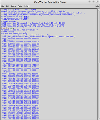

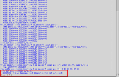

4) Setting "log v" in CCS does provide more information (thank you for the good suggestion) when I tried to erase 2M memory on QSPI flash, it says: ERROR(4): Cable disconnected (target power not detected)

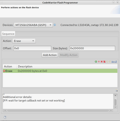

Flash Programmer screen capture:
CCS Printout with "log v" command and write_memory actions:
CCS printout when error returns:
So, my question would be: why this doesn't happen when erase small chunk of QSPI memory? do I need different power cable for my target device? Any suggestion will be deeply appreciated.

Result: Tried both MT25QU512ABA and MT25QU128ABA, same result, could erase small chunk, but not large chunk. See following screen capture:
Tao2022_0-1666274246112.pngTao2022_0-1666274246112.pngTao2022_1-1666274388535.pngTao2022_1-1666274388535.png

Tao2022
Update, I found that the "ERROR(4): Cable disconnected (target power not detected)" was caused by our hardware watchdog, when flash programming progress stuck, the watchdog kickoff after two minutes, then the CW complaints that the target lost power.
After disabled the hardware watchdog, the "target power not detected" error is gone, but the flash programming process will stuck forever (if I erase/write more than 1M bytes), till I manually power off the target board.
Anyone has any suggestion? thanks in advance.
