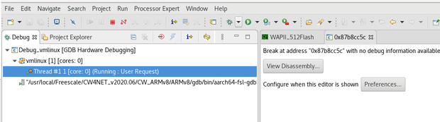

- Connect to the device by clicking "debug", NOTE: the middle window seems to indicate we are broke at some address 0x87b8cc5c.
- Click Suspend in Codewarrior. NOTE: The suspend button is greyed out but the resume button is not enabled.

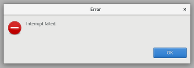

- After about 20 seconds An error box comes up.
- At this point I am stuck since I cannot type in the u-boot terminal or resume the processor.

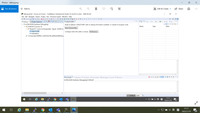

Please configure Debugger and Startup panels carefully following the document which I mentioned. After connecting to the target and click suspend button, you should get the IDE similar as the following.

Thank you for taking time to help. However, I must be missing a step becasue I have repeated the steps you outline in your document, several times, and I still cannot get it to debug the linux kernel.
Do I need to use a special u-boot? I am using the u-boot from our distribution OpenWrt.

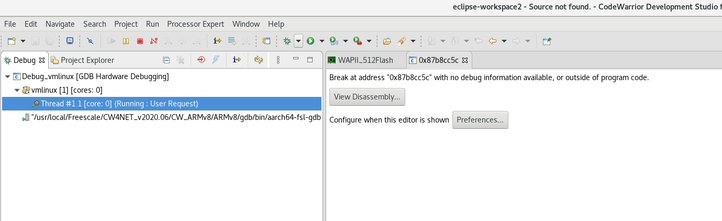

I get to the uboot command. Attach with the debugger and it stops but it apears to be lost. I can set the break point and resume but I cannot then type anything into u-boot. It is frozen.
I get the following in the debug console after attaching.

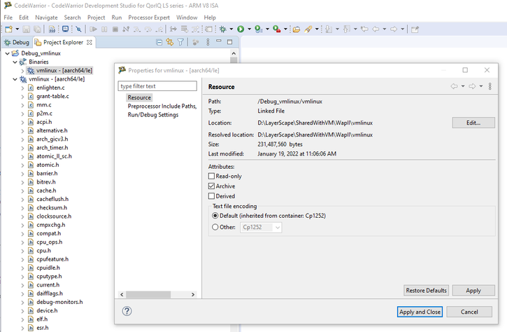

reginaldstjohn
OK, I am going to need more detailed directions then

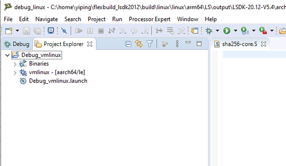

I only have one workspace, the one I sent you.  The project I was using to debug shows up in the project explorer as shown below. It was created by following the document you pointed me to. I "Imported" the vmlinux image I want to debug and set up the project as specified in the document. What is it you want me to send you?
Attached you will find exported Debug and Project settings

Please download the attach Linux debug project.
Please open CodeWarrior IDE and specify the workspace as <your path>/debug_linux.
Then copy your vmlinux file in folder debug_linux.
Then connect to the target board, click "suspend" button in CodeWarrior IDE, type "break _text" in debug console, click "resume" button in CW IDE, continue to boot Linux Kernel in u-boot.

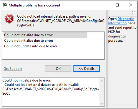

First issue is codewarrior keeps giving me the following error after I close it, restart it, and then choose the workspace.
Now, once I reinstall CW for the 3rd time I proceed to follow your instructions.

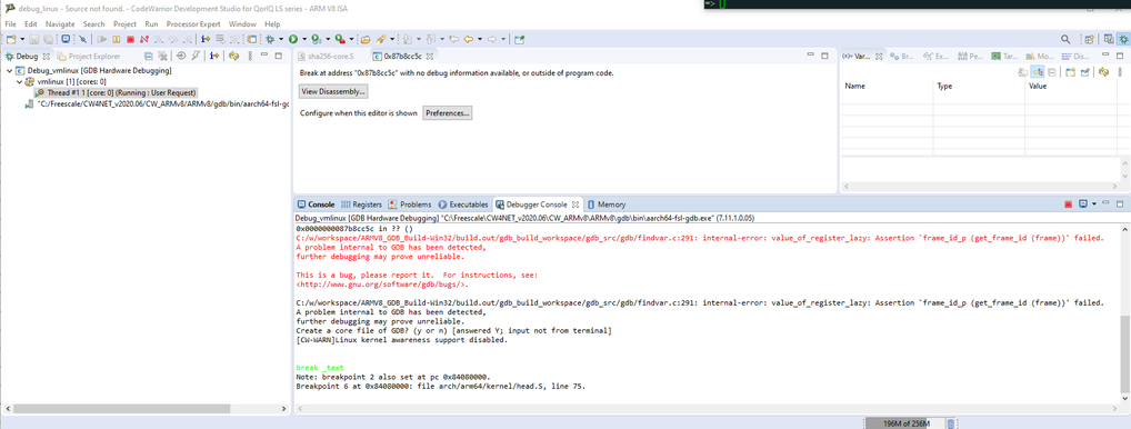

The project would not find my vmlinux, even after copying it to the debug_linux folder. This is because the vmlinux in the project had an absolute path to its location on ypingwang's machine. I changed the properties of the the vmlinux file in the Project Explorer tab to point to my vmlinux file.
Then I connected to the target with uboot stopped at its prompt.
I see the following error in the debug console (see picture below). Seems like it is not going to work.
I add the breakpoint and hit resume.  At this point uboot is frozen and I cannot launch the kernel
Sorry, but I seem to be at the same spot I was before. Am I missing something?

When I connect with the u-boot work space you gave us to try (debug_kernel) I can connect, suspend and then resume u-boot with no problems.
If i use the vmlinux debug workspace (debug_linux) you or I create then when I connect I get the gdb error mentioned above and u-boot is frozen. I cannot resume because I can't suspend.
