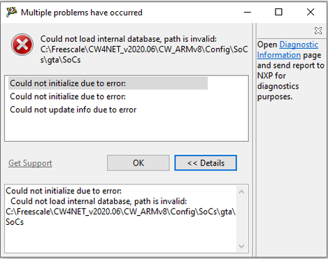

First issue is codewarrior keeps giving me the following error after I close it, restart it, and then choose the workspace.
Now, once I reinstall CW for the 3rd time I proceed to follow your instructions.

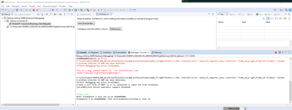

The project would not find my vmlinux, even after copying it to the debug_linux folder. This is because the vmlinux in the project had an absolute path to its location on ypingwang's machine. I changed the properties of the the vmlinux file in the Project Explorer tab to point to my vmlinux file.
Then I connected to the target with uboot stopped at its prompt.
I see the following error in the debug console (see picture below). Seems like it is not going to work.
I add the breakpoint and hit resume.  At this point uboot is frozen and I cannot launch the kernel
Sorry, but I seem to be at the same spot I was before. Am I missing something?

When I connect with the u-boot work space you gave us to try (debug_kernel) I can connect, suspend and then resume u-boot with no problems.
If i use the vmlinux debug workspace (debug_linux) you or I create then when I connect I get the gdb error mentioned above and u-boot is frozen. I cannot resume because I can't suspend.
