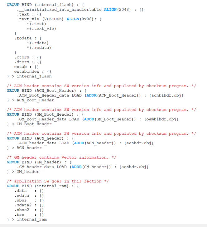

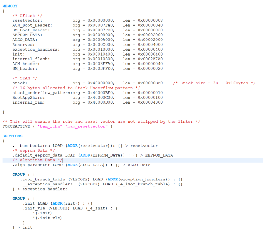

When i do compile, it report errors below, but i check the lcf file, i can't find where can result this issue
>linker command file 'acnblhdr.obj' is missing from project.
C:/Freescale/CW MCU v11.1/MCU/PA_Tools/Command_Line_Tools/mwldeppc|Linker|Warning
>linker command file 'oemblhdr.obj' is missing from project.
>linker command file 'acnhdr.obj' is missing from project.
>Overlap of the ROM image address of .text_vle section with executable address
>of .default_eeprom_data section.
>Overlap of the ROM image address of .text_vle section with ROM image address
>of .algo_parameter section.
>of .ivor_branch_table section.
>of .__exception_handlers section.
>of .init section.
>of .init section.
>of .init_vle section.
>of .text_vle section.
