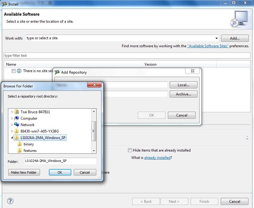

3. Install CodeWarrior patch (LS1024A-2MA_Windows_SP.zip)forLS1024/MA

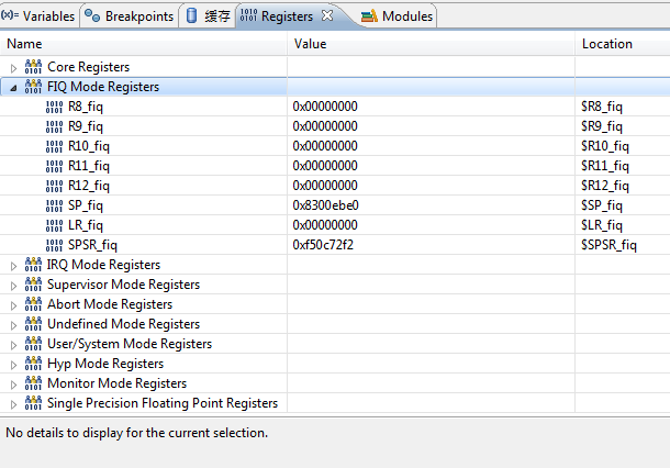

7. Window->Show View->Registers. Only ARM architecture registers you read here.

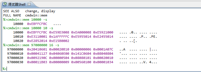

8. If you want to read peripheral device controller register, please use shell mode
   Window->Show->Debugger Shell
CodeWarrior Debugger
Shell v1.0
%> cmdwin::mem <device based address>+offset -s
(use command “help cmdwin::mem” to get the detail )
