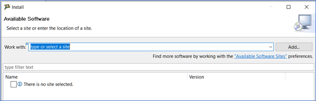

  1. Go to Help/Install New Software menu
  1. Select the Available Software Sites link

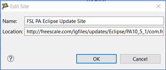

  1. Select the Eclipse Update Site and Edit.

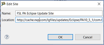

  1. In the Location address, replace the freescale.com text with cache.nxp.com. Then press OK twice, until you go back to the Available Software window.

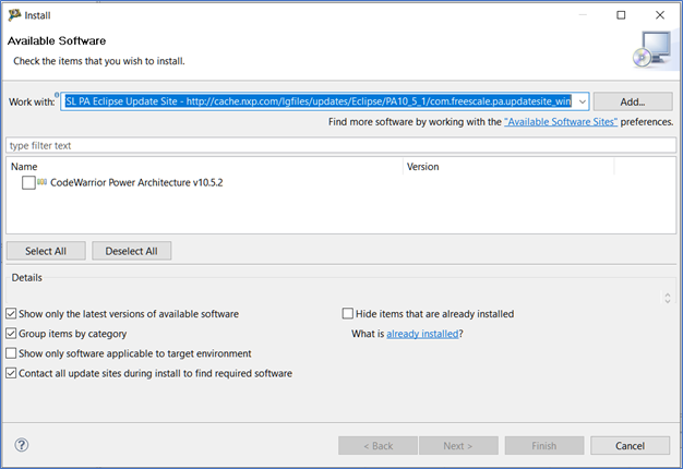

  1. Select the updated Eclipse Update Site and install as usual
