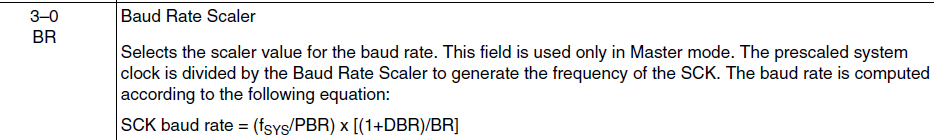

hello sir ,
i have used TWR-K20D72 freescale board. in this board i connect CAT25256 (EPROM). i have write data in eeprom memory but faced a problem because of my initilization problem also problem of data write and read.
my system clock frequency is 72mhz. i have set  1 mhz baud rate for spi and how to set it.

void spi_init(void)
  SIM_SCGC5 |= SIM_SCGC5_PORTD_MASK;      //Turn on clock to D module
  SIM_SCGC6 |= SIM_SCGC6_SPI0_MASK;       //Enable SPI0 clock
  CS_GPIO_CONFIG;                // Configured GPIO
  CS_DIR_OUT; // Select CS pin as Output direction
  CS_DISABLE; // Disable CS
  PORTD_PCR1 = PORT_PCR_MUX(0x2);    //Set PTC5 to mux 2 [SPI0_SCK]
  PORTD_PCR2 = PORT_PCR_MUX(0x2);    //Set PTC6 to mux 2 [SPI0_MOSI]
  PORTD_PCR3 = PORT_PCR_MUX(0x2);    //Set PTC7 to mux 2 [SPIO_MISO]
                SPI0_MCR |= (SPI_MCR_MSTR_MASK |   //DSPI is in Master mode.
  SPI_MCR_HALT_MASK); //Stop transfers
  SPI0_MCR &= ~SPI_MCR_PCSIS(1);
      // how to set 1 mhz???please write a correction
  SPI0_CTAR0 |= (SPI_CTAR_PBR(3) | SPI_CTAR_BR(0x04));
              //Frame Size = 8 bits
              SPI0_CTAR0  &= ~SPI_CTAR_FMSZ(7);
              SPI0_MCR    &= ~SPI_MCR_MDIS_MASK; //Enable module

sir, i am currently used IAR embedded workbatch software.
In this how i can set 1MHZ clock frequency.
how SPI0_PUSH & SPI0_POPR worked???

Hello Harshad,
Please refer to the calculation formula of  Reference manual
Alice
