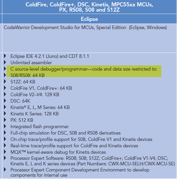

Can you help me please.  I have an easy question. I got the following software notification
Thank you for your interest in CWX-MCU-PROED-EX_11-1. We hope you are enjoying your experience developing with NXP software.
Our records indicate that your product will expire on 03/19/2019.
As always, please feel free to contact us with any questions you may have at nxp.com/support.
Thank you for including NXP as part of your solution.
I tried to answer in several ways, but that was probably not intended.
my text therefore here.
Thank you for your reminder.
I have download this CodeWarrior f. MCU v.11.1. and want to use it to program an 8.bit nxp controller.
I still need to do something to use this software. I have not started it yet because I do not have a development board yet.
What should I do? Do I have to register the software and how?

Hello Gerd Meinert,
Thanks for contacting our technical support, I will serve for you.
There are four CW licenses: Special, Basic, Standard, Professional. About detail please refer to
CW suites quick reference guide, I attach if for you.
When just download and install, by default, it can used as Professional version in 45 days, after that,
it will change to Special version.
If the Special version can meets your requirement, you needn't to anything, just ignore that information.
If can't . you can refer to your needs to buy CW license.
This is for Special editions:

Hello
Now I underständig software notification.
It is a friendly reference to this context.
