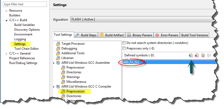

Does the Codewarrior Compiler automatically create a symbol which indicates which controller is used? Just like other Embedded Compiler do.
Something like:
#define DEVICE K60_FX_512
#define DEVICE COLDFIRE_xxxx
I would like to enable processor specific Code automatically by checking those symbols (if they are available)
Thanks and Regards
Markus

I think I found a solution. The project wizard creates the derivates.h File while setting up a new project. This includes the controller specific header File. I can use the macro definition of the Include Guard to check which controller is used.
Is it correct, that it is not possible to change the controller derivate used in a project?

Jorge_Gonzalez
Hello Markus:
CodeWarrior does not automatically create those symbols, but you can add them very easily either in your code or directly in the project settings, just by going to Project -> Properties. Look at the next screenshot:
Hope this is useful!
Jorge Gonzalez

Hello Jorge,
Thanks for the feedback. You are right; I could add such a symbol manually in the Project settings.
But when I change the target Controller of the Project, I have to change the symbol manually. And this will be forgotten often; ending up with strange errors. That’s why I’m searching for a solution which changes the symbol automatically.
