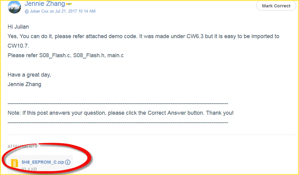

ZhangJennie
Hi Julian
Yes, You can do it, please refer attached demo code. It was made under CW6.3 but it is easy to be imported to CW10.7.
Please refer S08_Flash.c, S08_Flash.h, main.c
Jennie Zhang

Hi Jennie,
You forgot to attach the attachment!!!!

ZhangJennie
Hi Julian,
I did attached it. see:
Can't you see it? if not, please send me your email, I can send it to you. I just followed you. you can add me then send your email address with message.
Jennie Zhang

juliancox
Contributor V
It eventually appeared. I think it was something to do with my browser (Safari)
Thanks.
