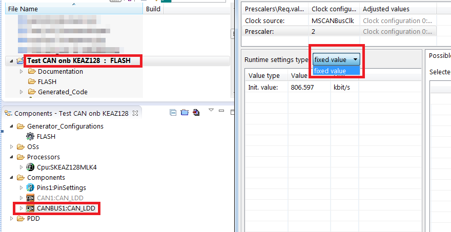

I have a TRK-KEA128 board and I'm developing a  can bus project. I am using Code Warrior 10.6 and Processor Expert and I setting the LDD_CAN component with bit rate @100kbits/s and listen only mode.
Is there a way to setting the bit rate in run time? I need to connect the board to various can bus networks that I don't know the bit rate.

ZhangJennie
Hi Paolo.
I contacted the processor expert developer today.  I got there is not supported list of values in the timing dialog of the CAN_LDD component (see the screenshot below). There is also not any method of the component that provides configuration of the CAN device timing. I am sorry but this functionality is not supported by the CAN_LDD component.
Jennie Zhang
