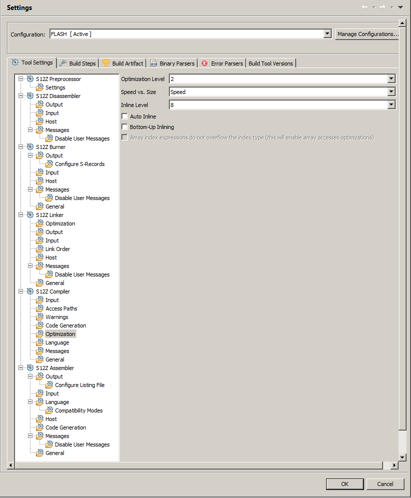

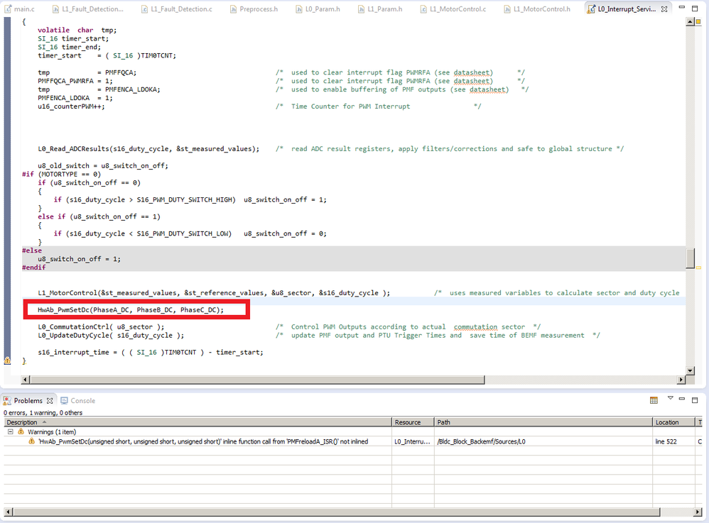

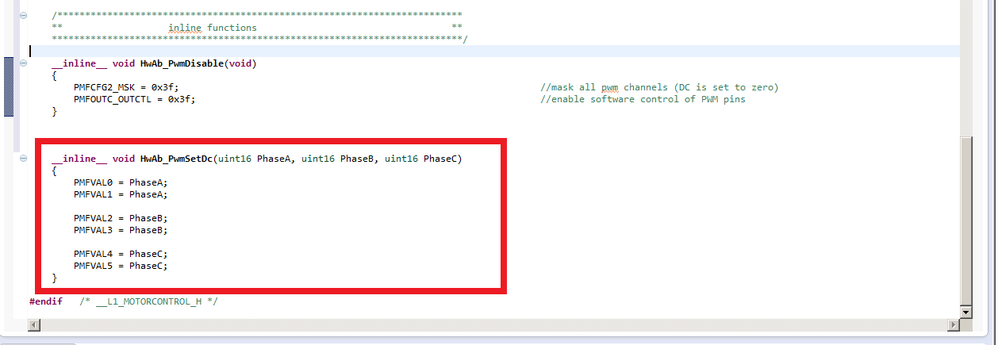

markuskandler
Thanks for your answer.
The original code where the inline function is called looks like this:
The inline function itself is defined in the module header:
Project Compiler Settings:
I've already tried various compiler settings (especially inline and optimization level).
Markus

markuskandler
thanks for your answer. I tried your suggested Settings but with my Project it make no difference. I still got the warning that the function cannot be inlined.
I've also tried to setup a new project, but that didn't change anything.
