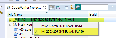

Hello
I just finished my firt application with MQX lite (and first application with Processor expert) for a KL15.
program works fine but when I turn on card supply without SWD, nothing happens ! LED life is not flashing, the various tasks do not work ...
How is this possible ? what should I do ?  activate in PE ?
thank you in advance
PS : My SWD is a multilink universal (green one)
1,119 Views
ZhangJennie
please check these two possible reasons:
1. made sure your code is download in Flash but not RAM.
2. make sure you do not have selected any of the "XXX_hosted" options.
Re: MK10DX256VLK7 doesn't run standalone, just when debugging. Verified it's running from FLASH, not...
can this help you?
