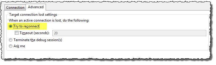

Hi, is it possible to debug while I enter in Low Leakage Stop mode using codewarrior and P&E multilink universal?
At the moment when I excute  asm("WFI"), the debugger disconnects.
Any idea?
Thank you.
Stefano M.

Sorry for the delay. I confirmed what you mentioned and my comment in your other thread, the debugger loses connection when entering any of the low leakage modes, but you can set a wake up source (e.g, an external pin) and indicate the debugger to reconnect. This is made from the connection settings. Just go to Run -> Debug Configurations -> (Select your connection here) -> Edit -> Advanced. In here select the option "Try to reconnect".
Also, as an extra hint, if you step over the WFI instruction, the low power mode will not be triggered.
