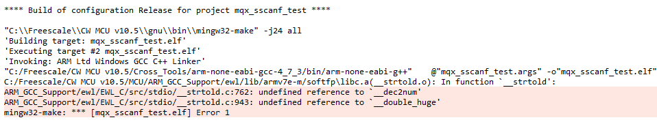

I'm working with TWR-K70F120M tower along with EWL C/C++ and MQX libraries inside CodeWarrior v10.5. I'm trying to use the sscanf() function and find that I get undefined references:
ARM_GCC_Support/ewl/EWL_C/src/stdio/__strtold.c:762: undefined reference to `__dec2num'
ARM_GCC_Support/ewl/EWL_C/src/stdio/__strtold.c:943: undefined reference to `__double_huge'
mingw32-make: *** [cpac_message_test.elf] Error 1
As far as I can tell, it looks like my EWL libraries don't have floating point support compiled in? I've tried rebuilding all EWL libraries with the _EWL_FLOATING_POINT definition defined in the makefiles, but that doesn't appear to help. Can someone point me to a possible solution?

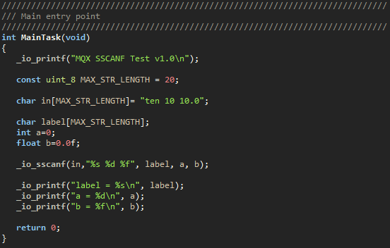

I've still not resolved the issue. I've posted my test below:
EDIT: that should be _io_sscanf(in,"%s %d %f", label, &a, &b)

rseal
Hi Pascal,
I am able to build this using a standard C project, as you've shown, but my problems relate to a C++ project that links in the BSP and PSP C libraries.
I was able to partially get this working by replacing the "_io_sscanf" call with "std::sscanf", which forces the program to use the standard implementation instead of the mqx version. However, that version does not seem to have float support out of the box, which leads me back to questions about enabling floating point support for the EWL C++ library?
Has anyone there worked projects that use EWL C++ combined with the MQX libraries? That's where things have gotten weird for me. We've had some success with this, but it's been mostly trial-and-error.

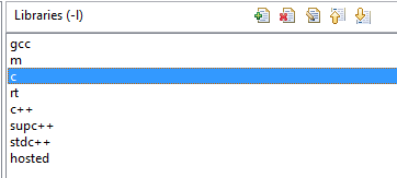

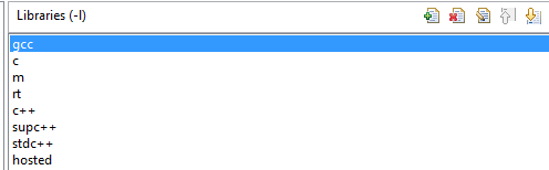

Thanks for the help. We are well versed with the complexity of mixing C, C++, and the MQX libraries. Our project currently contains more than 100 files, mostly C++, but we do have others writing pure C code. We've invested quite a bit of time understanding the subtleties in the MQX vs. C++ projects. I agree, the setup is quite tricky, but we have to understand every aspect of the setup to reduce risk given the size and scope of our project.
I ran through your setup as suggested and everything appeared to work correctly as you stated. I was working a different, but similar (i.e. undefined references related to libstdc++) problem last week and stumbled onto the solution. We have quite a few custom libraries linked into our project and had neglected the order in which they were seen by the linker.
Here's a stripped-down version of our original link order that caused the undefined references:
After reordering the inclusion of "libm" and "libc", the problem has been resolved:
Thanks again for taking the time to look into the matter.
