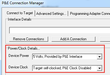

I still have a question:
I have cyclone pro configured (through switches) to provide power and clock to the board when programming it. Should I change this behaviour to debug the sw while normal working ?

Carlos_Mendoza
Hi Paolo,
It is good to hear you found the problem.
If while normal working the MCU is self-clocked and has its own power supply then you need to change the jumper setting and also update the debugger settings:
Hope it helps!
