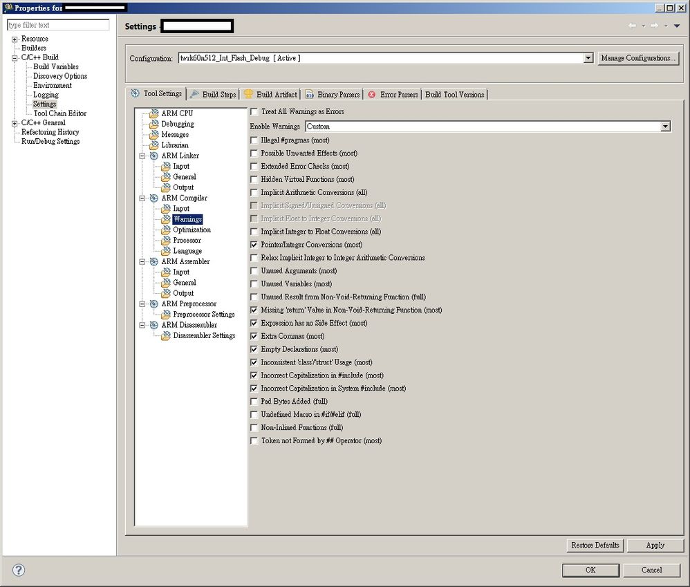

leslieyang0509
Dear Catherine,
NK60DN512
100MHz
mask 2N22D
Here is the snapshot of settings.
Leslie

CrasyCat
Specialist III
Hello
  Go to the ARM Compiler > Language page and check the Require Function Prototypes edit box.
CrasyCat
2,608 Views
leslieyang0509
Dear Catherine,
it works!
Thank you.
