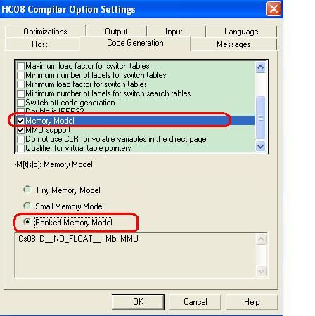

I need to change the memory model from small to banked on a HCS08 project. I have been using processor expert for the project and was able to make the change on the cpu and changed the model in the linker
but I am still getting incompatible model messages for some of the previously loaded libraries etc. Is there a step by step procedure or checklist for the change.

To change processor expert project from small model to bank, we need to modify three places:
  1. in CPU properties, set memory model to Banked:
2. in compiler setting, set Memory model to banked:
3. in project management window. change included memory from ansiis.lib to ansibim.lib:
After above three steps, the pe project will change from small memory model to banked.
Hope this helps!

Jennie,
Thanks for the reply, I was able to get it changed over.
