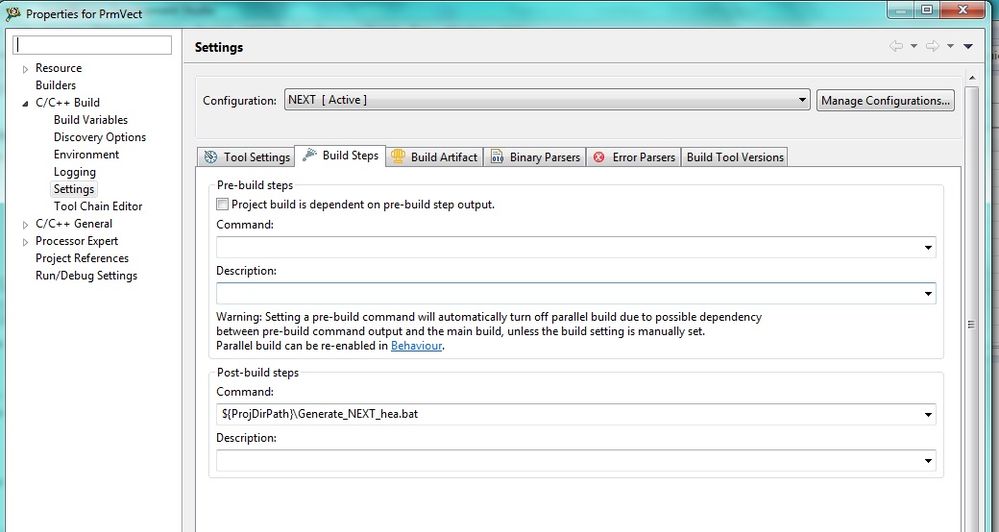

I need to copy the .elf.s19 file out of the build directory every time I run a build.  What is a good way to accomplish this?
1,567 Views
GottiLuca
In CW 10.x , you can use the Post-build command ( i.e. : calling a .bat that copies that file whenever u like ) .
See attached picture showing what i've ( note that in this case the .bat is placed in the project directory ) :
More can be found on the CW 10.x manual.
