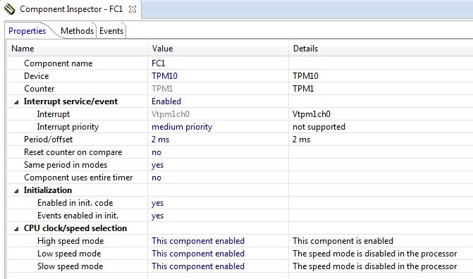

I am using a free running counter on a S08QE16 cpu to generate a periodic interrupt every 4ms. The interrupt occurs every 8ms irrespective of the value I set for "Period/offset" for component FC1 using device TMP10.Screen Shot 2018-03-07 at 12.33.11.jpg
With the settings shown above I still get an interrupt every 8ms.
By examining the timer registers (using a breakpoint) the counter is counting, but TMP1MOD contains the value 0x0000. If I then enter a value of 0x8000 into TMP1MOD I get the timing I need. In the hardware initialisation code there is only an instruction to set  TMPMOD to 0x0000. Do we have a problem with ProcessorExpert?

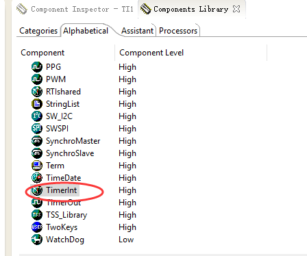

Hello Julian Cox,
How about use the "TimerInt" component :
Hope it helps
TIC
