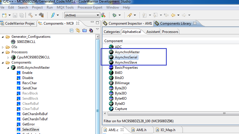

thanks TICS_Fiona. Now i got the way to build code.One more think it there any Beans for 485 comm. in freescale?
9,998 Views
TICS_Fiona
RS485 is normally UART/SCI based communications, you can use Processor Expert to help with your software. There are three components avaiable for UART/SCI communications, they are AsynchroSerial , AsynchroMaster  and AsynchroSlave. I think you can make use of AsynchroMaster and AsynchroSlave. image_png.png

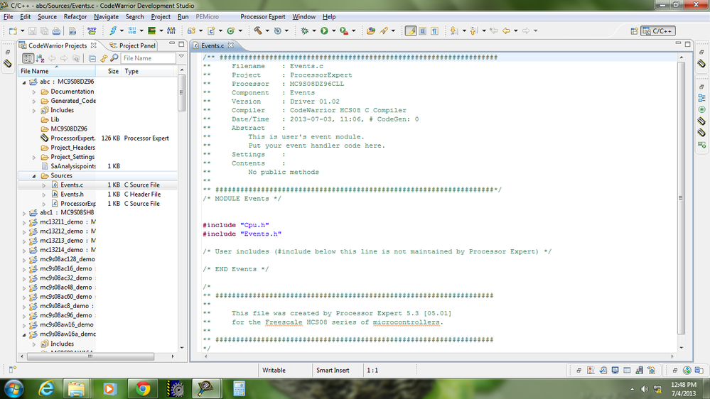

Thanks for rply TICS_Fiona & JunZhang.. Now i installed CodeWarrior™ Development Studio for Microcontrollers V10.2 software.I start new project with following steps File=>New=> Bareboard Project=>name of project"abc" which is store in C:/user/workspace (as a default)=> select MC9S08SH8 MCU => P&E full chip simulation => Processor Expert => Finish. Till this its OK then i can not find .C file.can u please help mehow to genarate .C file with Proccessor expert option.

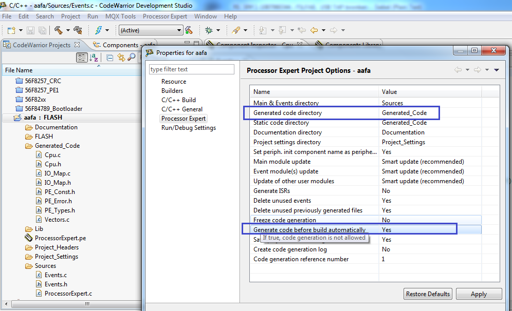

TICS_Fiona
Or, when build the project, the code will be generated by PE, user may not manually click on the menu or button to do it.
Becuase the option 'Generate code before build automatically' is set to 'yes' by deault.
The PE generated code is placed uner 'Generated_Code' directory, user can chang this directory as well in Project Properties.Please see this screenshot.

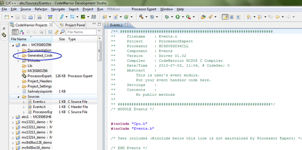

TICS_Fiona
PE generated code is placed under "Generated_Code", please click on the triangle to expand it. See this screeshot: image_png.png
