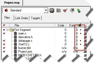

Then let me ask you this: under what circumstances would the linker link every object file except for some and without error? This is the situation I'm facing now and I can't see any reason for it. I have 102 object files that need to be linked. The linker links every single one of them except for the same two files. No error is generated so you assume everything was built fine until you examine the project.map file and realize that both of those files, and all labels within, are not included. What's common between these two files is that they include the interrupt vector table and all interrupt service routines. Note that the entire code is relocatable and written in assembly.

Hi Murat.
Could you check if the black dots are enabled for these two files you mentioned? This will inform linker to link the specific file.
If the black dots are already enabled for these two files, I would suggest you send your project to NXP support directly to check it.
