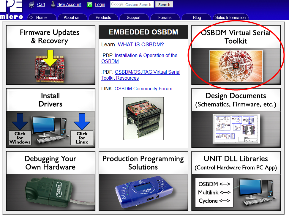

Hello Julian,
My PC is Win10 64 bit, I can install it without any problem.
I download from PEmicro site : http://www.pemicro.com/osbdm/ , please have a look at attachment.
What about the problem when you install ?  Please take a screenshot about the errro .
You can also search the error reminder in PEmicro support  site :http://www.pemicro.com/support/index.cfm
Alice

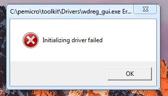

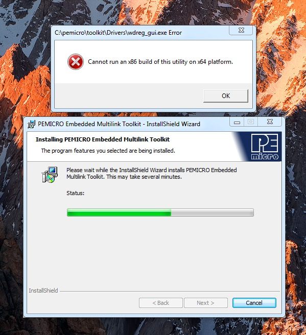

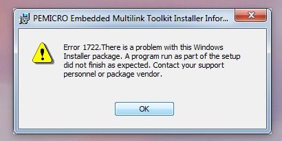

juliancox
Contributor V
As requested, Attached is the screenshot.it stays like this - no progress - until I select OKScreen Shot 2018-04-26 at 13.05.00.jpgScreen Shot 2018-04-26 at 13.05.37.jpg
It then rolls back the installation
7,885 Views
Hello Julian,
It seems your tool version is not the same with mine:
I download from : http://www.pemicro.com/osbdm/
Alice
