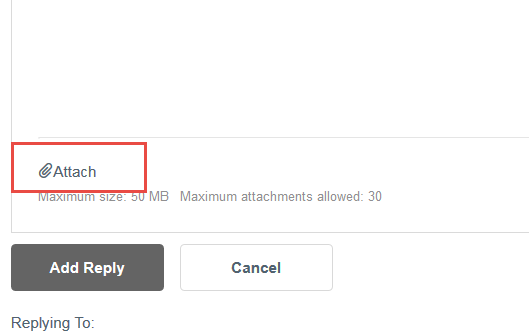

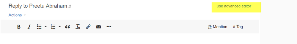

Regarding to your specific problem, I need to check your project directly please click "use advanced editor", then
then you will see an attached button under the text field
Please attach your entire project, rather individual files.
Jennie Zhang

Plus I am not getting the option Advanced Editor as per the image shown by you for sharing the filesadvacnededitor.JPG
