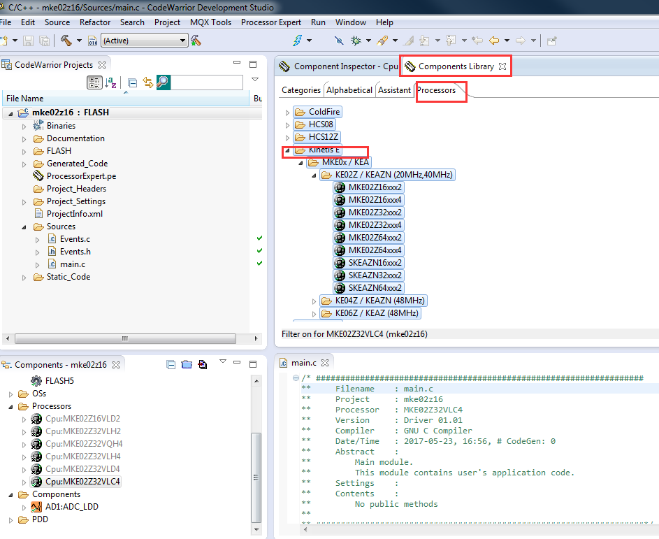

Hello Michael,
- As to there is difference between 9S08QE and  KE02Z16, so the code size is not the same.
For example maybe kinetis chips more peripherals than S08 chips, then more registers and
more interrupt, so kinetis will use more memory .
- About change chip, you can try to directly change as below, double click the chip you want to use,
then clean project, generate code, build project.
Hope it helps
TIC
