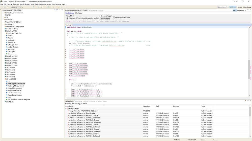

I'm learning to use CodeWarrior 10.6.4 and I have configured 6 PWM High level Beans and 5 IntTimers, to use de functions 'Enable', 'Disable', 'SetRatio8' and some others I drag and drop them from the bean to de main.c code file, but when I build the project all of that functions have the error 'undefined reference to'. I don't know what else is needed to do to make it work or if there's some other way to declare such functions.

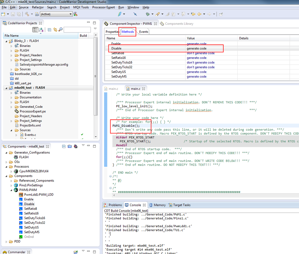

Please enable this Methods , you can use it without any error , here :
Hope it helps

Thank you very much!, I guess it was pretty basic stuff hehe. I'll post my last question to finally make my project work.
