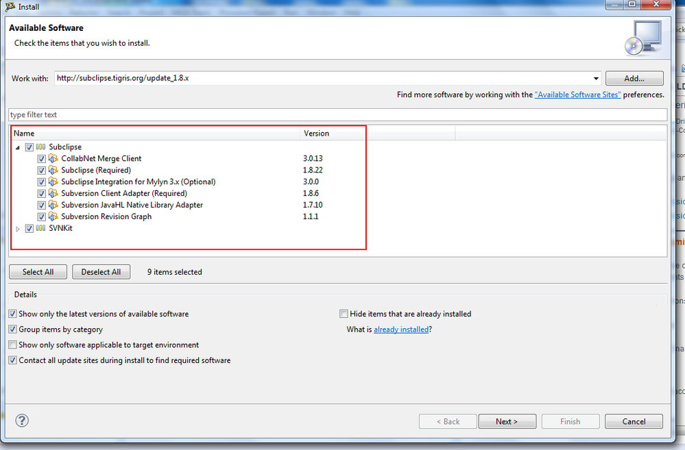

Dear all,
I'm working with HCS08SG32 and I tried to add SVN support to my CW 10.6.4. Build Id:150416.
CW 10.6. does not have Eclipse Marketplace so I looked for SVN plugin update site, both subclipse and subversive, but no installation was ok because of missing Mylyn integration.
So I looked for Mylyn and I tried with both 3.19 and 3.8, but there's always some missing dependency.
How can I come out of it?
Thank you very much in advance for your kind reply.
Best Regards
Roberto

Thank you Alice!
Subclipse 1.8 installation was fine!
But anyway I got this error when I right clicked on Project / Team /Share Project /SVN
org.apache.subversion.javahl.ClientException: Unsupported working copy format
svn: This client is too old to work with the working copy at

Just to update that with subclipse 1.12 it's all OK now, but just after having installed 1.8 first as Alice suggested me.
Thank you very much Alice!

Hello Roberto,
Please test this:
Click "Help" "Install new software" Click "Add" to add the site URL "http://subclipse.tigris.org/update_1.8.x"
After install it , you can refer to this thread to use SVN :
How to install support for Subversion on 10.6.4 (latest CW)
Also you can use GIT to control your project version:
https://mcuoneclipse.com/2013/08/13/installing-egit-in-eclipse-and-codewarrior-for-mcu10-4/
Hope it helps
