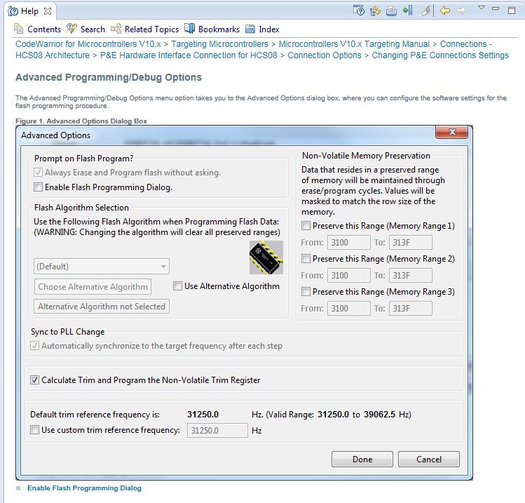

I am using CodeWarrior 10.6.4.  I was using an MC9S08QB8 device, but I needed a few extra pins to be able to also use my serial port for dumping data to a computer terminal, so I switched to an MC9S08SH8, which has 4 extra pins in a TSSOP package (pins 1-8 and 13-20 are same functions as previous device in the same location, and adding pin 9-12 extra functionality).
After starting a new project as an SH8, and copying all of my code to the new project folder, when I try to start the debugger, it gets to "Initialization" and pauses for awhile, then I get this error: "Error measuring trim values".  [OK]. "The trim value could not be measured properly".
How can I get around this?  I am using the internal oscillator, not an external oscillator, if that helps.  I am not (knowingly) doing anything to the trim values.

I found the following in HELP about a checkbox that enables calculation of the Trim value and programming the Trim Register, but I can't figure out how to get to that particular Window/Dialog:

Jennie:
Yes, that helped very well.  Thank you.  After following the path to get to that checkbox, I unchecked it, and then the Debugger started up, programmed my code into the processor, and I was able to run.

On invoking the debugger with the SH8 device and this small BUSCLK test program, I again got the error where it couldn't read the Trim values, so I performed the same procedure from your video to un-check the "Calculate Trim and Program the Non-Volatile Trim Register" checkbox, but the debugger still would not start up, giving me the same "Error measuring trim values" error.

My apologies.  I spent about a half-hour gathering screenshots and diagnostic information from the error that was being generated to send to you, only to realize that, when I was trying to ZIP my project, that I had not changed the derivative of that old project from the QB8 device to the SH8 device.  After creating a new Assembler project for an SH8 device and copying the code for main.c over to the new project, the debugger started up with no problem.
