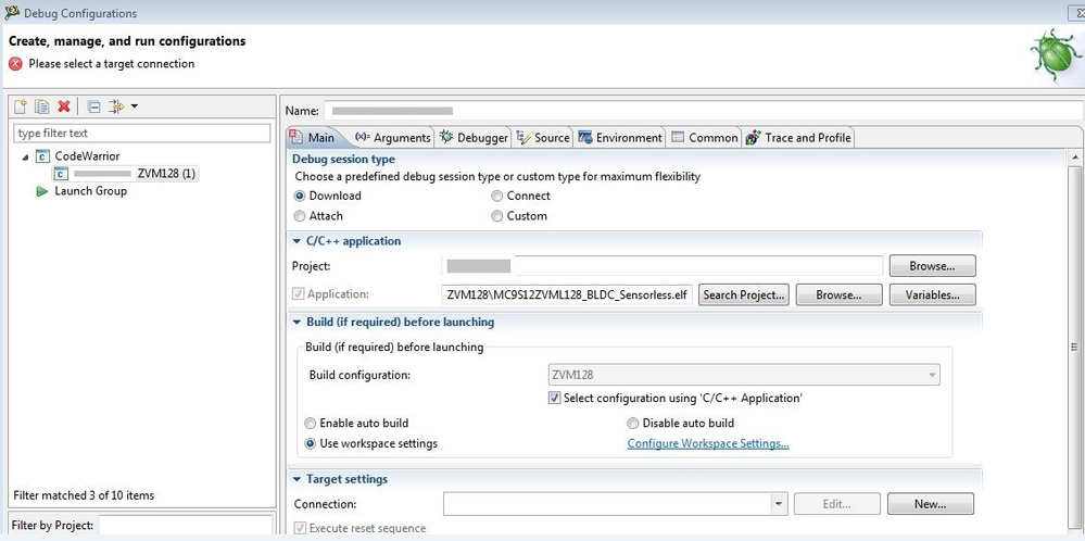

I am using codewarrior V10.7.
I have issue regarding target connection setting.
Sometimes it will not show target connection setting when i import existing project in CW workspace as below,
I am not getting why this is happening,is there any issue in codewarrior or issue in our project import setting or something else.
Request you to guide for the same.
9 Replies
4,166 Views
Hello PRATIBHA SURABHI ,
You can add a debug connection interface into your project.
There is a document describe the steps in detail, please have a look at my attachment .
Hope it helps

Can you please tell me as to why the Connection in the Target Settings disappears sometimes?
4,166 Views
Hello PRATIBHA SURABHI,
It seems when delete the .launch file ,  open the project again, the debug configration will disappeared.
Hope it helps
TIC
4,166 Views

Can you explain a situation or a a scenario where the above mentioned .launch files would get deleted?
I faced the problem of target connection  missing when i imported the existing project.
How can the .launch files get deleted when importing a existing project?
4,166 Views
Hi PRATIBHA SURABHI,
I test many ways to export and import project , while can't reproduce this problem.
What about your steps ?
Alice
4,166 Views
pratibhasurabhi
Contributor V
Even I performed the same steps.
I directly import an existing project.
Also i tried by deleting the launch file(1 file).it ddint work
I tried after deleting the PEMICRO files (2 files ) such that the debugger folder was empty.
Still i was able to see a target setting.
4,166 Views
After delete, please close the project, then import it agin.
Or import it on other workpace.
Alice
