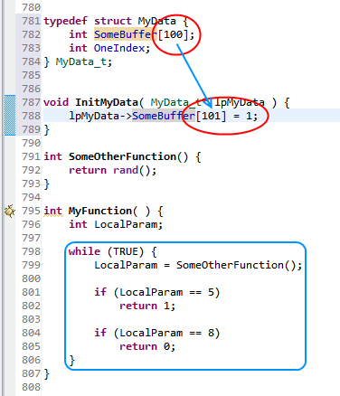

VictorLorenzo
Hi Zhang,
Yes, I was already aware of that analyzer included in the CW IDE, in fact I'm using it sometimes. But in my opinion the results from that tool are not yet reliable. For example, see the picture below, in one hand the tool reports as a bug something that (probably) is not exactly a bug but (perhaps) a bad programming practice. In the other hand, it does not recognize one severe security flaw (buffer overrun) in the function InitMyData().
The function named MyFunction() does have a return statement, but the tool reports the function as not having a return statement. The function InitMyData() is writing to one location out of bounds (2 bytes out).
This two isses are correctly detected by some other tools like FlexeLint, which only reports as a bug the out of bounds access in function InitMyData() and reports these two messages:
Warning 416:  Likely creation of out-of-bounds pointer (2 beyond end of data) by operator '['
Warning 415:  Likely access of out-of-bounds pointer (2 beyond end of data) by operator '['
