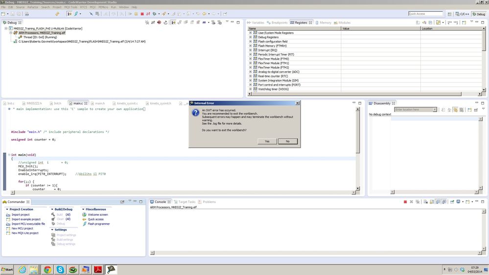

I'm using CW 10.5 since two weeks, and I've experienced some problems.
  1. I'm not able to use keyboard for writing programs as I was used with other IDE, e.g. CW 6.3 or similar: I use often CTRL+INS, SHIFT+INS to copy part of text and paste it in other parts of the program; I use very often CANC for erase part of the text. I can't understand why but CW 10.5 don't let me tu use this keyboard functions!! I've to use right mouse button and select copy and paste, I can't use keyboard and it's quite a problem for me, because time for writing increase a lot! Does anybody experience this fact?
  2. When I'm debugging and program is running, if I try to double click and put a breakpoint CW tell me there's a fatal error and close entire application. I can't understand while I can't put a breakpoint during normal program running.
I hope somebody can give answers!

Regarding to Ctrl+C, Ctrl+V and Delete key, this is a known issue as bug ENGR00299766 in CW10.5, the next update will fix this problem.
For the debugging problem, would you please test whether everything works well if first put a breakpoint CW then start debugging? And what is the part number of your target MCU?

I'm using MKE02Z32/MKE02Z64 MCU, and I don't have problems if I put breakpoint before start debugging. Also if I use "Run To Line" there's no problem. The only problem is when I try to put a breakpoint while system is running. I've attached to this mail a screenshot of message I have from CW. It happens sometimes, non every time i try to put breakpoints.

Hi Roberto,
it is very hard to reproduce your problem on my side, could you please upload your project and let me the detail steps on reproducing it?
such like where you want to put the breakpoint.

Now I understand how attach a file to discussion. I've attached zip file of a little project that I'm using with FRDM-KE02Z and PEMicro Multilink Universal. Sometimes, as I told you last time, if I put a BP while program is running, CW crashes and I've to restart IDE.

Rick_Li
Hi Roberto,
I'm  so sorry for the time delayed!
I've tried your project on my side on CW v10.5 for many times, and tried to put BP on someplace when program is running.
it works well without any problem.
so, I doubt if there are some problem on your CW installation, may I suggest re-installing CW 10.5 on your side?
PS: CW v10.6 should be released in next month, so, if this problem is not critical, then, I would suggest installing CW v10.6 when it available.

robertogiovinet
Hi Yong Li,
Thank a lot! As I told you, not all the times BP causes crashes! I will follow your suggestion :smileyhappy: and I'll install CW 10.6!
