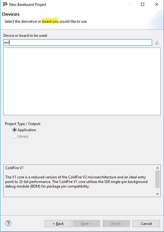

I'm using a M54451EVB development board.  I'm asked for the derivative or board I would like to use:
However, it is unable to find my board.  In fact, when I expand all the options, it doesn't look like there are any boards in there.
Is there a way to set up a project to use the a specific dev board, particularly the M54451EVB?
Thank you.

You create a "New bare board project"  which doesn't support selecting board as target, thus you can select chip dirivative only. The "board" you highlighted confuses users. I will report it.
If user use SDK or MQX, board can be selected. but we need check if the SDK or MQX supports this board.

Yes, MCUXpresso doesn't support codefire.
you use Coldfire M54451EVB , you need use CodWarrior. I just checked MQX doesn't support his board.
As I know we do not have any plan for MQX to support M54451EVB.(Only the M54455EVB are supported in MQX4.x.)

If don't use MQX, we can only choose "derivative" only.
