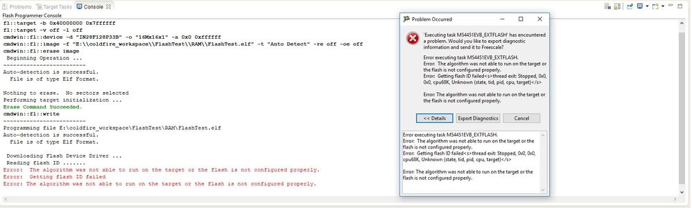

I'm Using ColdWarrior 11 to tr to program the flash on the M54451EVB dev board.

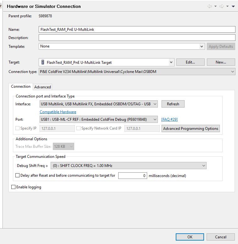

I'm using the USB Multilink, USB MultiLink FX, Embedded OSBDM/OSJTAG- USB connection.
I'm also using the M54451EVB_SPI.xml and M54451EVB_EXTFLASH.xml algorithm/configuration.
I get an error when I try to program the flash:
"Downloading Flash Device Driver ...
Reading flash ID .......
Error: The algorithm was not able to run on the target or the flash is not configured properly.
Error: Getting flash ID failed
Error: The algorithm was not able to run on the target or the flash is not configured properly."

Here is a image of my hardware connection page:
Any help would be appreciated.  Thanks :smileyhappy:

Hi Zachary,
As discussed by the internal case, you can use the linker and configuration files from a MC54451 project created in CodeWarrior 7.2 as base for your build and debug configurations.
Hope it helps!

I've attached the configuration for the board to the post since CodeWarrior 7.2 won't run on anything passed Windows XP.  In case any one in the future runs into the problem.
