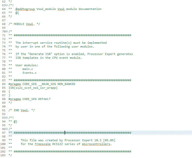

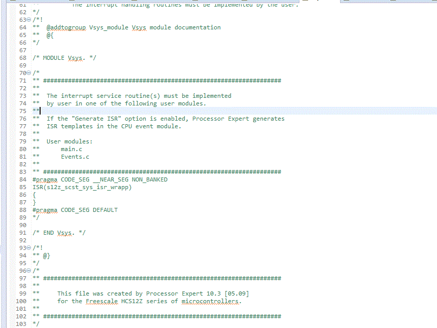

I have generated SWI and SYS interrupts using processor export
->In modules ->vector table ->Vsys,Vswi configured and code generated .while building code its saying functions undefined in Vswi.c file contain definition but its commented ..is their any problem to create Vswi,Vsys.

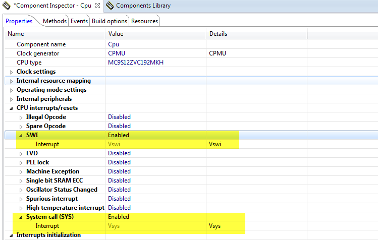

ZhangJennie
Hi Rajesh,
You can enable these two interrupts  in CPU properties. then generate pe code, you will see the related vector and  interrupt function generated. See attached video.

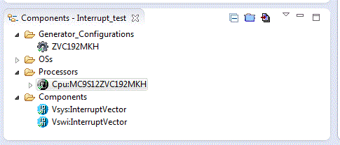

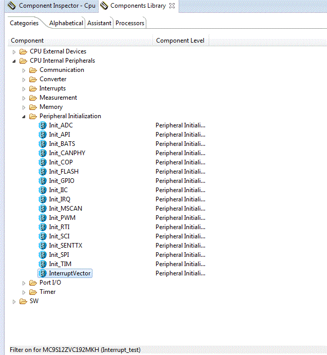

rajesh057
Hi pls find the above pics I can able create interrupts from components ...but ur suggestion in cpu component inspector is it both are same .

Hi Rajesh,
I believe your last two screenshots are generated by component InterruptVector. Something like Vsys.c. Vswi.c
In CW10, these c files from InterruptVector component  are commented. To use the generated functions, we need manually copy them for example
to User modules:
main.c
or
Events.c
These are also suggested under comments.

ZhangJennie
Hi Rajesh Kota
Regarding to your questions:
>>1)My question is Both process of creating interrupts different but result is it same ?
Answer: Correct.
