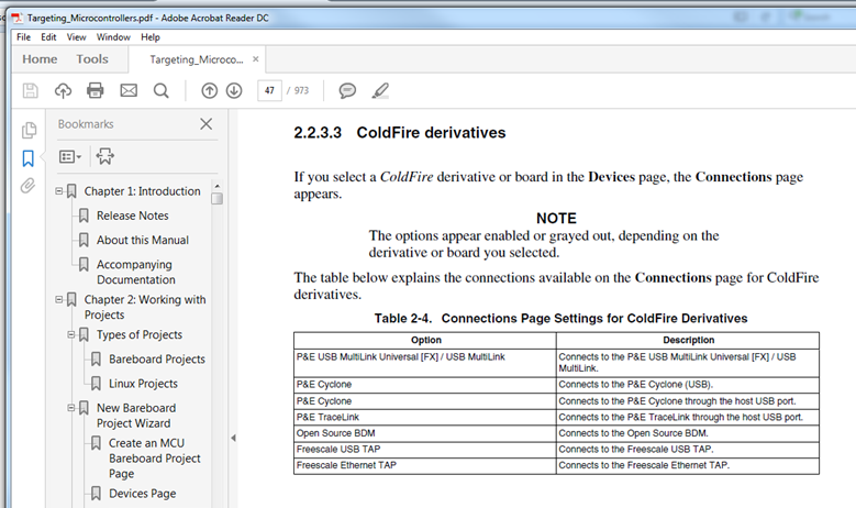

trytohelp
Hi Michael,
Below the extract of the Targeting manual:
The debugger is not supporting Monitor how it was for CW for HC08 or HC12 classic tools.
Does an interface can be used via LAN connection ?
Multilink and OSBDM required connection between PC and interface with USB cable.
Cyclone and Tracelink Ethernet can be connected with PC through IP address.
     Please have a look to the "Chapter 12 Connections - ColdFire V2/3/4" of  \MCU\Help\PDF\Targeting_Microcontrollers.pdf
Ethernet Tap is the NXP solution but this interface is not available anymore.
It was replaced by CodeWarrior TAP but this new interface is not supporting Coldfire.
Pascal
