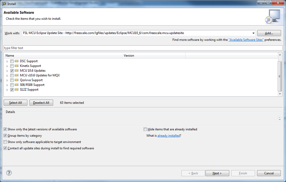

hi Young kyun,
first please make sure you have install the latest update for CW10.6. if not, please do it.
if you already install the updates but still have this problem. we need to reproduce it first. thus please send us your project folder in zip format and your generated .sx to us.
