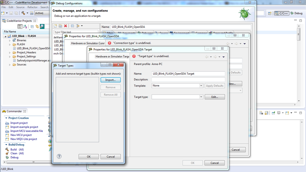

I'm new in freedom KL05Z. Started with Quicksrtart Package and updated Bootloader to v1.11 and PEMicro App to 1.14. After that installed CodeWarrior 10.6, imported Projekt LED-Blink.
After that build the project without errors. Only an information in the console was occured:
**** Build of configuration FLASH for project LED_Blink ****
"C:\\Program Files (x86)\\Freescale\\CW MCU v10.6\\gnu\\bin\\mingw32-make" -j16 all
mingw32-make: Nothing to be done for `all'.
But when debug, there is following error:
Error creating session: Invalid target type selection in connection "LED_Blink_FLASH_OpenSDA"
I don't know how to solve the problem. I did everything step by step what is descriped in quickstart guide.
Hopefully someone can help me. Thanks

Jorge_Gonzalez
Hello a bergman:
Can you point me to which example project you imported?
The error implies that such project is not for KL05. Try verifying this in Run -> Debug Configurations -> Edit -> Edit. Check the attached video for reference.

abergman
Thanks for your helpfull answer.
I imported the example LED_Blink from package KL05-SC (KL05-SC\klxx-sc-baremetal\build\cw\LED_Blink).
And yes, there is no target selected. But when I want to choose one, there are nothing to choose.
Therefore I looked in the path Freescale/CW MCU v10.6/... . No config-file for  MKL05Z32VFM4 in there. Where do I get the target from?

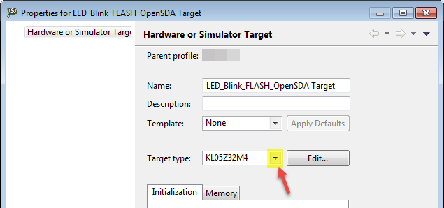

Jorge_Gonzalez
Hello a bergman:
That is strange. I imported the same project and the target appeared in my case. From your picture it seems you clicked on the "Edit" button., but to select a target you have to click on the little black arrow as in the next image:
If the list is empty, then something might've gone wrong with CodeWarrior installation. Try a complete reinstall with administrator privileges and if possible with any antivirus or firewalls disabled.

abergman
Hey Jorge_Gonzales,
thanks for your help, but nothing has changed.
I uninstalled everything from CW, also the example Code. Then I downloaded the CW installer from here:
https://freescale.flexnetoperations.com/control/frse/download?agree=Accept&element=5901381
and did the full installation. After that I imported the example project...and the same errors occured.
