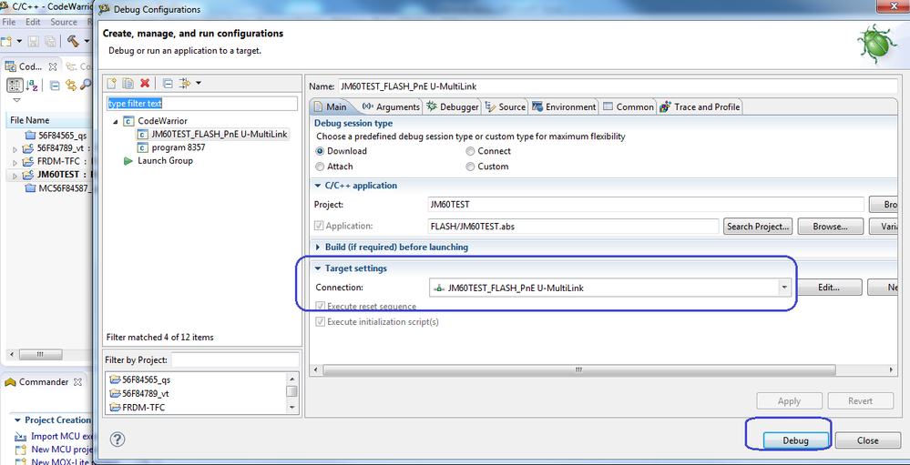

Good Evening
Could someone tell me wich is the process to program a target, for example a JM60 with the Multilink Universal?
I am working with Codewarrior V10.6
As far as i understand I can program the device and I can debug the device.
How can i Do both of them? Which are the steps to follow?
Thank you so much in advance?

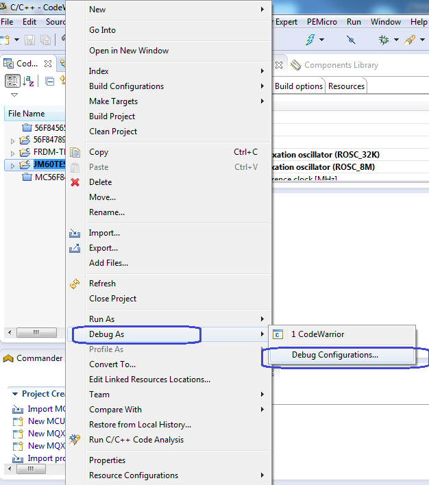

Hello Luis
To program and debug the device, please right-click on your project name, and select "Debug As -> Debug Configuration".
Then choose the correct connection type, and click on Debug button. The debugger starts programming the MCU with your firmware, after programming, user can start the debugging in IDE.
For how to use the debugger, please refer to  <Chapter 4 Working with Debugger> in Targeting Manual:
http://cache.nxp.com/files/soft_dev_tools/doc/user_guide/CWMCUDBGUG.pdf
