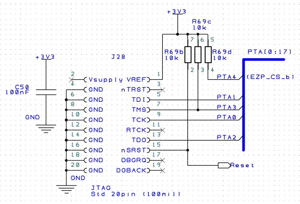

My K10 target is a new board I've designed. You can see the JTAG schematic here:

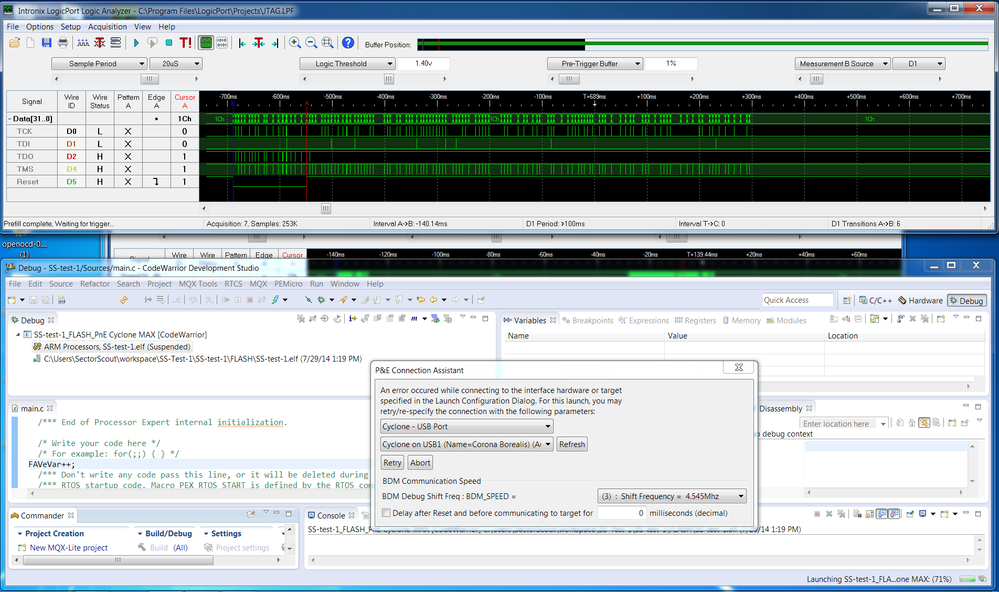

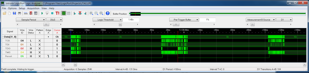

I have connected a logic analyzer to the JTAG pins and I can see some communication on all lines, but I'm not quite sure what to look after.
It looks like the communication stop after a short while.
The activity can be seen here:
From CodeWarrier:
When I press Abort in P&E Connection Assistant, I get these details:

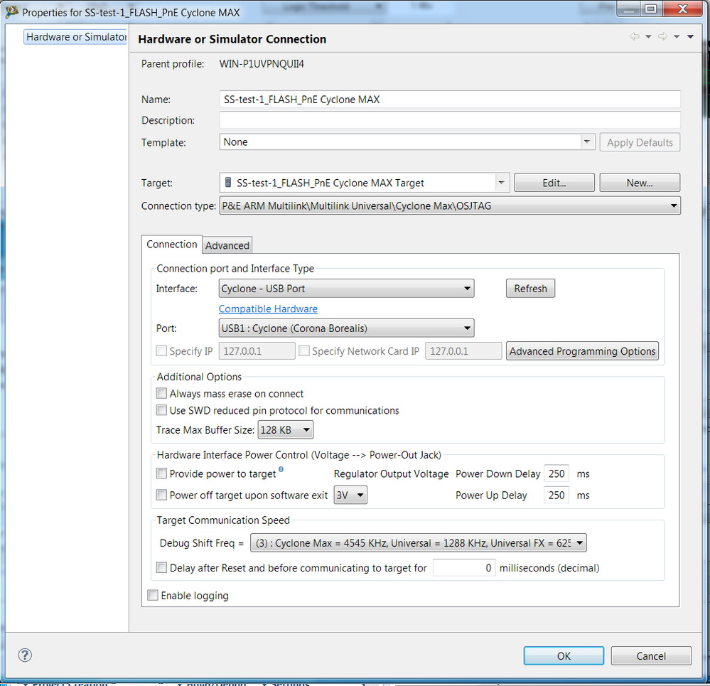

Setup can be seen here:
CodeWarrior:

Communication is set to ARM CORTEX 20 PIN and I'm using 20pin, 100mil connector as shown in schematic.
I'm NOT using the adaptor board.
It's very possible that there are a Hardware problem in my board, but I've spend several days looking for it and I can't see the problem myself.

As far as I can see from the datalogger, there are some communication going on, but for some reason it stops.
The first part of the JTAG communication seems to take place, while Reset is held low - is that normal?

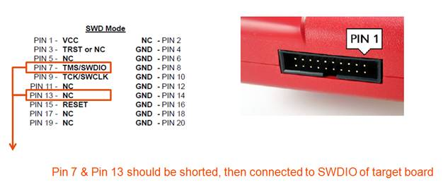

thomaskang-b295
Maybe it can help you because I had similar problem, then it was cleared.
Please short pin 7 and 13 of 20-pin connector as below.
I double checked to P&EMicro and got the answer.
The Cyclone Max was designed prior to the existence of SWD. Because it was designed prior to SWD, the TMS/SWDIO pin is not bidrectional. To support SWD, we included a SWD/JTAG adapter to short TMS/SWDIO with pin 13. Our Cyclone Universal, which is our next Cyclone Product, will not require an adapter and will support SWD mode natively.
Hope it can help.

jorgesierra
We should also mention that the short on the connector is NOT present on the board side of things.
Cyclone     Board
TMS          TMS
TDO          TMS
TDO on the Board side DOESN'T connect to anything! This is very important and it took 2 weeks of my life.
