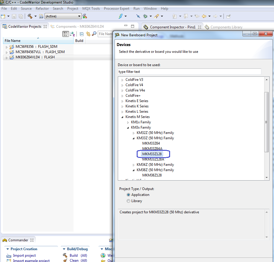

hello
i need create one project for MCU MKM33Z128ACLH5, but it does not support CodeWarrior.
thanks
1,035 Views
TICS_Fiona
Hello andres
CodeWarrior 10.6.4 supports MKM33Z128, please see the screenshot in below for new project creating.
Please first install CW10.6.4 which can be downloaded from:
www.freescale.com/cwmcu10
Its update v10.6.5 is also available at the same link.
Further information and the release notes are available on the following Freescale community page:
https://community.freescale.com/docs/DOC-143655
