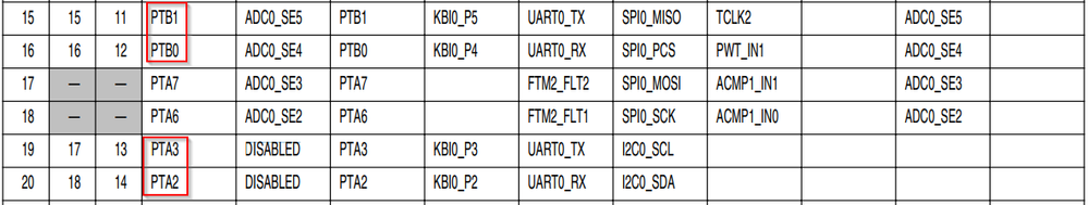

I am having the very same issue with my KE04 MCU.
When using PTB1 and PTB0 everything is OK
But when using PTA3 and PTA2 UART0 is not functioning.
I suspect that processor expert is missing something - configuration wise,
as PTA3, PTA2 marked as default=DISABLED on the table below.
Is anyone have any idea how to make it with processor expert?
