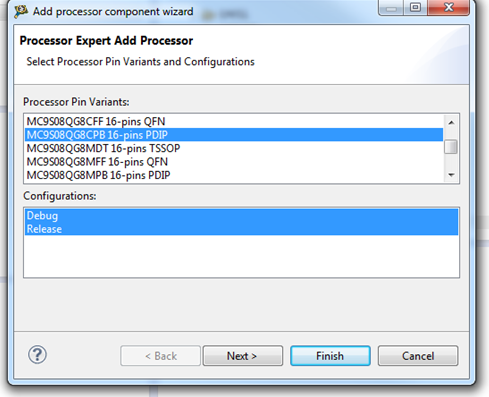

I am attempting to add a component to an existing project using the processor expert facility.  The component is an I2C component.  When I right click on the component in an attempt to add it to the existing project the "add to project" is greyed out.
What am I doing wrong or is this yet another issue with Code Warrior 10.6?

Hi Ronald,
The project sent doesn't include Processor Expert.
I've created a project based on mc9s08qg8 with the wizard including Processor Expert.
I can add the InternalI2C bean without problem and build the project.
I'm using CW for MCU v10.6.4 +Patch 10.6.5 which is the last version.
Attached you will find the example.

OK, I have brought up the test project, but the chip is wrong.   Your test project has MC9S08QG8CFK.  I need MC9S08QG8CPBE

Hi Ron,
You can change the device in the project sent or ...
I've created a new project for QG8 and changed the device.
To do that, click on Components Library and select the processor family: HCS08 - QA/QD/QG - MC9S08QG8.
Now in the dialog you can select the MC9S08QG8CPB.
Then I added the InternalI2C bean.
Attached the new project.

OK, thanks.  That worked.  Now I will determine if the existing project source code will compile and build.
